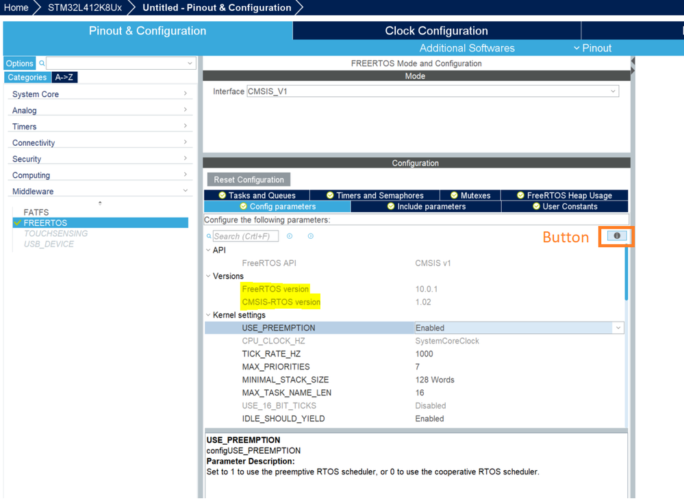

Im using CubeMX version 5.10, and about to start learning the freertos . Which version comes with CubeMX? I thought it was the version from www.freertos.org , but I see withng cubeMX the drop down allows CMSIS_1 (I am using STM32L4 and F7 processors). Can anyone tell me which one it is , and also a few pointers for a beginner to the freertos?

Many thanks for your reply. Attched is the drop down list of the interface, and it doesnt have freeRTOS. I read some place that there should be a selection for freeRTOS too.

​Hello @Scott Dev​  ,
To enable Freertos you should select one of the 2 version of CMSIS (CMSIS_V1 or CMSIS_V2) and depending on the availability.
Then, you can find under configuration-Config parameters versions of FreeRTOS and CMSIS and they depend on MCU and CubeMX version, also there is a button that can help you to use  parameters .

Underneath ST's bloatware it is the same normal FreeRTOS, but ST have made CMSIS-RTOS wrappers to it and CubeMX uses FreeRTOS only through these.
