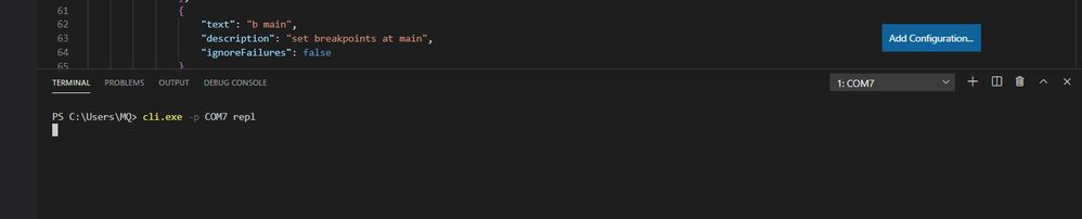

I just tested in VS Code, it was said COM7 connected, no problem no error, but I just could input into it, and could see output from board in it.0693W000007BxOHQA0.jpg
