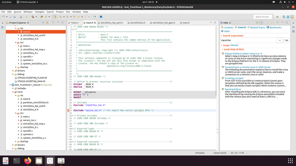

I made a project based on NECLEO STM32L552ZE-Q, when I made it from MX configuration tool, I found there was no "stm32l5xx_hal.h", while it was included in main.c, where could I find it?0693W000006HUTzQAO.png

It shows right in the console output:
from ../../Drivers/STM32L5xx_HAL_Driver/Inc/stm32l5xx_hal.h:30,
The "Drivers" folder is a top-level folder within your project.

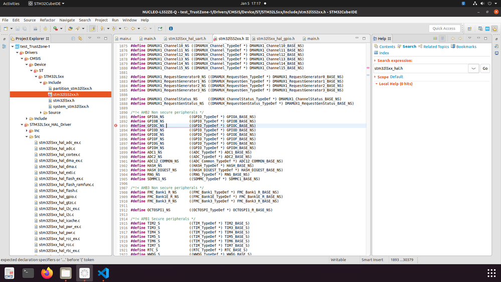

You've got some other usage errors happening. HAL_UART_Transmit requires a pointer, a length, and a timeout value. You're just trying to pass a raw string, which isn't even the right number of arguments.
Double check what modules are enabled in your project's stm32l5xx_hal_conf.h
This needs a timeout parameter
HAL_UART_Transmit(&hlpuart1, "\r\n the same state, do nothing. \n");
Yes, I found it, but the others are all set the same way, since this pin I used, so does that mean the configuration would rewrite the file "stm32l5xx_hal.h", and so my configuration has errors?
"This needs a timeout parameter"
For such error, Where could I get the HAL functions prototype(the documents) ?

for "Double check what modules are enabled in your project's stm32l5xx_hal_conf.h", I found these, is it enough?
#ifdef HAL_UART_MODULE_ENABLED
 #include "stm32l5xx_hal_uart.h"
#endif /* HAL_UART_MODULE_ENABLED */
#ifdef HAL_USART_MODULE_ENABLED
 #include "stm32l5xx_hal_usart.h"
#endif /* HAL_USART_MODULE_ENABLED */
HAL is open source, you can look at the source files directly to see how to use them. F3 will jump to the definition. There are also quite a few examples in the CubeMX repository that you can look at, although the L5 is relatively new and may not have as many as the other families.
If you enable these things within CubeMX, it will generate the code you need to run them, such as the definition of hlpuart1. That would probably be the easiest method to get started.
As far as what modules are enabled, your code snippet doesn't provide that info. Are the HAL_UART_MODULE_ENABLED and HAL_USART_MODULE_ENABLED #defines enabled? They would be higher up in that file.
