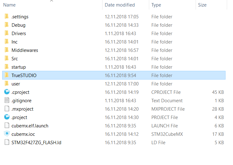

What's the TrueSTUDIO folder?
turboscrew
Senior III
When "Generate Under Root" checkbox is set the code generator doesn't create the TrueSTUDIO folder.
When "Generate Under Root" checkbox is not set it creates a TrueSTUDIO folder and places the project files, the startup file and syscalls.c there.

I don't remember the scenario - I was busy with something else for a week or so.
CubeMX was 4.27.0 and Atollic was 9.1.0 (and they still are the used versions).
The TrueSTUDIO folder contains "startup_stm32f427xx.s" and folder "cubemx".
The cubemx folder contains folder ".settings" and files ".cproject", ".project", "cubemx.elf.launch" and "STM32F427ZG_FLASH.ld".
Sounds like some kind of backup, but could be something else too.

I'm sorry, but I don't think so. I don't have the time.
It happened at work.
On the other hand, there seems to be no harm of it.
I try to check if it's just a backup when a new (fixed) project was generated on top of the old.
Yes, they look like backup - telling by the file dates.
