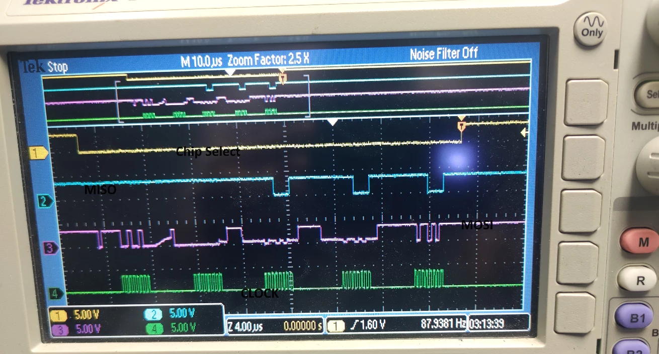

Seeing issue while brining-up Winbond W25X20L FLASH with STM32, Write and read a byte in a loop does not work.
Tried to see the signal's using the scope and seems like clock has some issue, appreciate any help. Please let mw know if more information is needed here.

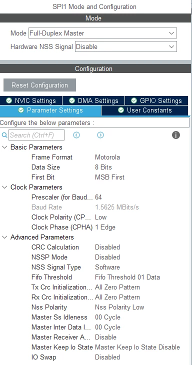

CubeMx Settings and code I am using is provided below
STM32CubeMX Settings for SPI1 after going through blog post like this Getting Started with STM32 - How to Use SPI (digikey.com)
Basically updated.
1. data_size from 4 to 8, 2. baud_rate to 1.5Mbps using 64 as Prescaler, 3. Disabled NSSP Mode

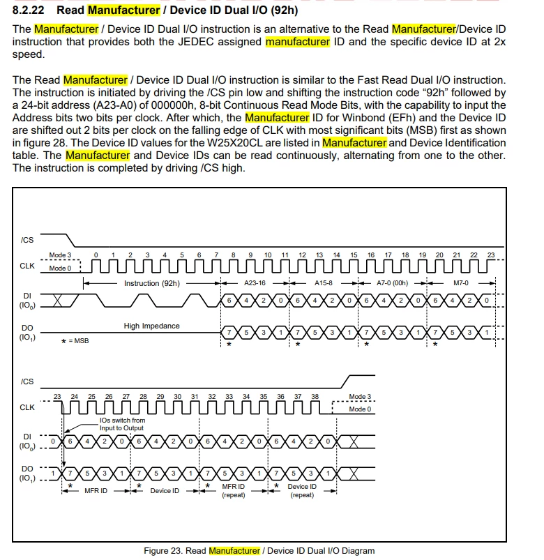

Simplified the program to just read the Manufacturer ID instead of write/read using 0x92 command

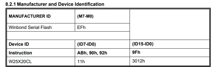

0x64 and 0xF0 is read back as manufactureID and deviceID

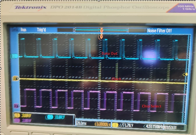

Here is what I see on the Scope.
Please let me know if there is anything, I am missing.

Use the HAL_SPI_TransmitReceive(), Identify traces, don't be using DUAL mode for single bit SPI, would explain the wrong levels on the Purple trace as both ST and WINBOND are trying to drive the same pin.
Use the 0x9F command (JEDEC ID). send 0x9F, then recover responses to sending 3 zeros.
Bus is symmetrical, the write clocks, data goes out on one edge, read back on the other.

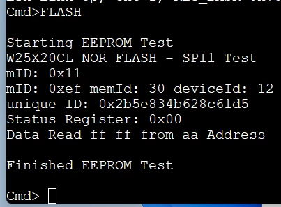

Thanks! I tried
  1. 0x90 --> Read Manufacturer ID
  2. 0x4B --> Read Unique Id
  3. 0x9F --> JEDEC Read (Device ID, Capacity and Memory Type)
    These seems to work, here is the response i am getting back
    Still having issue reading back Status Register and Write/Read command, really appreciate the response, here is the code I am using

 HAL_SPI_Transmit(&hspi1, &FLASH_RDSR, 1, 1000);
 HAL_SPI_Receive(&hspi1, (uint8_t *)&statusReg[0], 1, 100);
HAL_SPI_Receive(&hspi1, (uint8_t *)&statusReg[1], 1, 100);
HAL_GPIO_WritePin(GPIOB, SPI1_CS, GPIO_PIN_SET);
printf("Status Register: 0x%02X %02X\r\n",statusReg[0], statusReg[1]);
Tesla DeLorean
Guru
September 16, 2023
I would suggest using subroutines. Pass and decompose the address into the command bytes buffer.
You should spin after the WRITE (0x02) command, reading SR1 until SR1.BUSY goes back to zero, then do the READ (0x03).
aahsanAuthorBest answer
September 28, 2023
Finally, it is working for me, tried to put up reference and instructions in the attached .pdf file.
