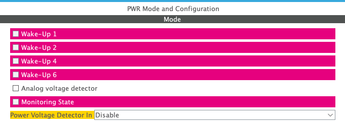

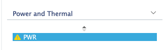

Right now I am having to manually alter the code after each generate
0693W00000FDWQ7QAP.pngI would expect it here
But all I see is
What am I missing?

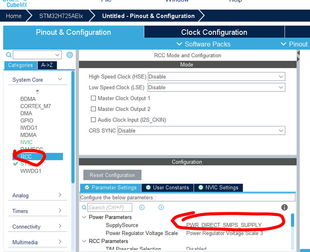

The power supply source setting is under "System Core" in the RCC tab.
1 REPLY 1
