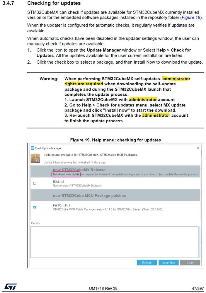

Can you please refers to the CubeMX User Manual UM1718.pdf or follow these instruction [Extracted from CubeMX UM]:
Main attention:
1- You need to start CubeMX as Admin (right mouse click > 'Run as administrator')
2- Perform the CubeMX upgrade
3- Close CubeMX
4- Re-start again the CubeMX as Admin to finish the upgrade process

Install the newer version into a separate directory. I've got 3 or 4 versions installed to support various projects. It appears to default to (in Windows) install in "C:\Program Files\STMicroelectronics\STM32CubeMX". I just change that last "CubeMX" part to, for example, "CubeMX_6_6_0". Then manually create desktop shortcuts.
