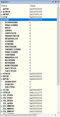

Registers look like:
exception description:
   The processor has escalated a configurable-priority exception to HardFault.
  A precise data access error has occurred (CFSR.PRECISERR, BFAR) at data address 0xc8d0245c.
   Exception occured at PC = 0x800a26a, LR = 0x8007c47
Hope this helps.

Hello @farrelldw
According to the fault analysis, it seems you are reading from a bad address 0xc8d0245c (invalid pointer being passed to the function). So, this may not be solved by just increasing stack size but also check state of your pointers: pxContainer in the initialization.

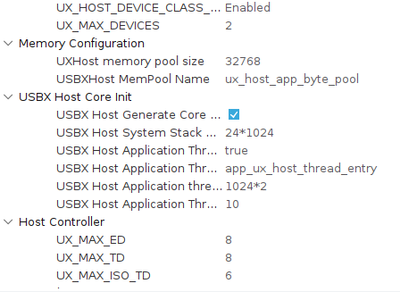

Hi @farrelldw ,
I cannot say much about freertos+usb , but as i see your stack size here ... :)
I made an audio USB host , with Azure rtos + usbX ; crash...until i made the memory area big...
see my settings:
your > we increased to .stack_size = 512 * 4
mine 32K pool + 24K usb host stack + 2K app
So try with more memory .
