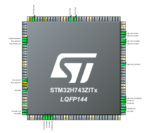

I'm currently using NUCLEO board H743ZI-Q and using software STM32CubeIDE.

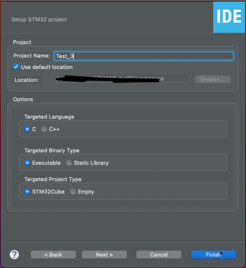

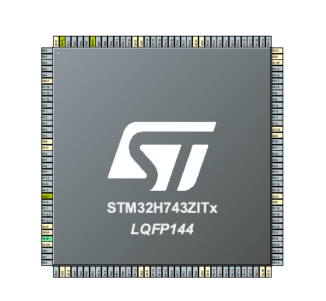

The first time I build a new project everything is going fine. 0693W00000BZufTQAT.pngBut when I build the second project, after I choose the project name and press finish, I cannot initialize all peripherals with default mode. There is not an option for me to choose. As shown in the pics.0693W00000BZuglQAD.png0693W00000BZufiQAD.pngHow can I correctly initialize all the peripherals?

In order to have this option, you need to select a board using the "Board Selector" tab instead of an mcu.
Just mean I start a new project.
SLi.14
I did select the Nucleo board, not MCU.

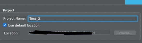

0693W00000Ba5nYQAR.jpgDespite you've not fully shared =) I'm able to see you're relying on 'workspace' as latest segment of you path ...
Takes care (Not STM32CubeIDE specific but Eclipse basis) such location has to promote a path including project repository !!!
In other words havng Test_3 project name I would be more comfortable to see <some path>/workspace/Test_3 as location ...
 By the way which IDE release are you relying on ? 1.6.x is adding some extra check about such location being safe (already discussed on such forum)
