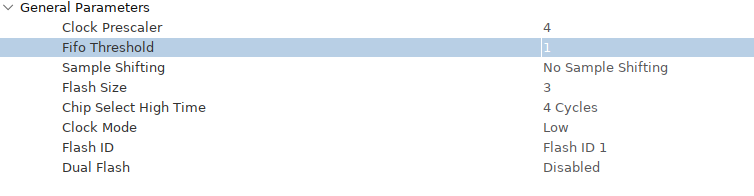

  1. Configure the clock so that QSPI is driven by HCLK3 at 240MHz (Should be scaled down to 48MHz after pre-scaler).
  2. Enable QSPI for Bank 1 using the following parameters (Figure 1).

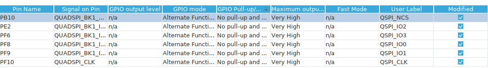

  4. Set GPIO to 'Very High' maximum output speed (Figure 2).

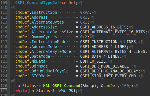

Once the code has been generated, I do the following to set up the QSPI command:

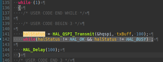

Then, once in the main while loop, I do the following where I will get blocked on that while loop. Debugger reports that halStatus is HAL_ERROR. Note: txBuff is a buffer of size BUFFER_SIZE filled with sequencing 0xAA and 0x55.

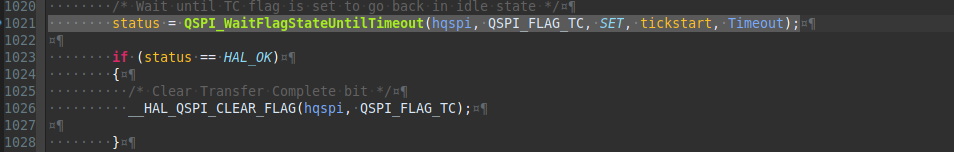

By looking through the HAL_QSPI_Transmit function, I've determined the following has been causing the error.

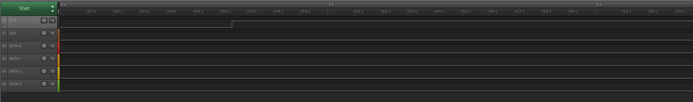

Where QSPI_WaitFlagStateUntilTimeout() fails due to timeout (seemingly independent of the timeout duration!). It seems to me that the hardware is never setting QSPI_FLAG_TC, and this will always fail. I get the following output with this set up on my saleae.
