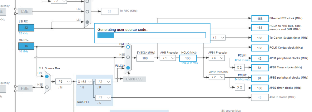

I dont know the reason of this issue, I just generate code via STM32cubeMX after enabling UART4 and below there is the main program!: But my program cannot neither receive nor transmit any data and stuck in UART_WaitOnFlagUntilTimeout. Help please

Here the clock tree

What STM32 and which package is being used here? Which GPIO for USART are selected?
mmed
its STM32F407 Disco, using UART4:
  PA0-WKUP   ------> UART4_TX
  PA1   ------> UART4_RX
S.Ma
Principal
Sanity check: If in main you use HAL_Delay() which uses systick, does it work?
This in case Systick is not properly working and all timeouts and delay functions are KO
