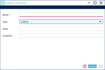

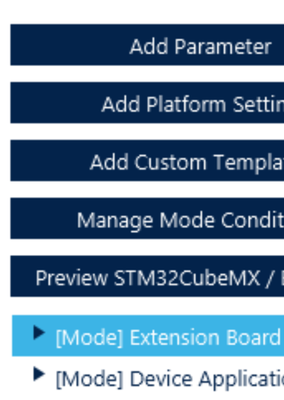

Update, the solution I used:
When using the Pack Creator, in the STM32CubeMX tab
Select the relevant "mode" on the left hand side
Select the "Preprocessor Defines" tab
Click on Add Define & select "Cdefine" along with the Preprocessor name & value if necessary.

‎2024-07-25 3:03 AM
