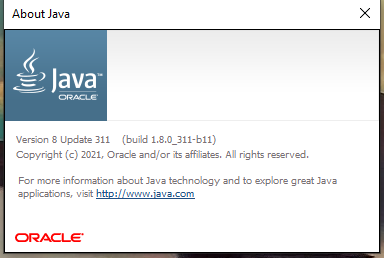

Hello, I'm having the same problem described above. I've tried uninstalling and reinstalling Java multiple times and I'm not having any luck. I'm running Cube v6.4 and Keil v5.36. Currently I have the JRE 8 installed on my computer downloaded from Oracle. I chose the Windows x86 installation. I'm trying to generate code for an STM32L053C8T Any help would be much appreciated!
MKell.6
@NKrau.1​i have download all the necessary file for your MCU, and generated a code with stmcube 6.4v i build the project and it had no errors, i dont own an stm32l0 devices, maybe there is something else not good configured0693W00000JOekcQAD.png
