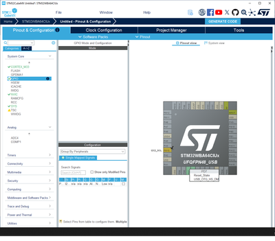

Why after last update the pins PD7 , PD6 are only with USB_OTG_HS functions:

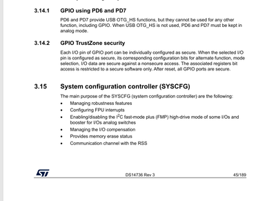

Hello @Brussl
According to the datasheet  DS14736 Rev 3, PD6 and PD7 are dedicated to USB_OTG_HS only, cannot be used as normal GPIO or alternate functions, and if USB_OTG_HS is unused they must be left in analog mode; therefore CubeMX showing only USB_OTG_HS functions for these pins is expected behavior.

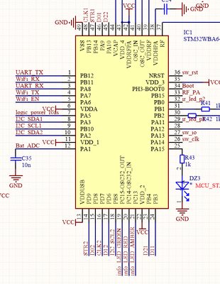

PD7 i use as custom SPI CLK output for SPI communication more than 1y. The device is produced before 1y ! Clock output is with 1mhz frequency. : This is my schematic. It is of working device:

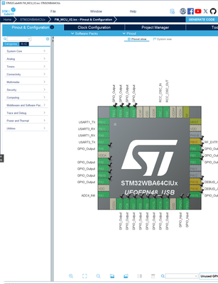

this is old project on FW_WBA V1.7.0
Can see the pins are outputs. And work well. But as i said when migrate to new FW_WBA. Pins are only for USB comunication. Where is the problem. I can send you also and IOC file.
