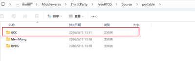

When using the IOC file in the attachment to generate code with an operating system, MDK-ARM V5.32 is selected. It is found that the directory ..\Middlewares\Third_Party\FreeRTOS\Source\portable\GCC is missing, resulting in compilation failure in Keil.

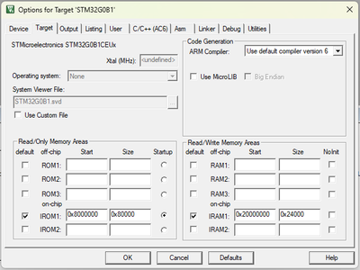

Which compiler version are you using? Are you using Compiler 6?

Yes, I am using Compiler 6
When I generate code using the attached IOC file, the directory of this GCC file (which I added manually) will be deleted automatically.

After checking internally , I found that this issue has already been forwarded to the development team under ticket #0061432.
Regarding your observation in your previous comment:
This is the expected behavior in CubeMX. If you add the GCC folder manually inside the generated project structure, it will be removed during code regeneration. To avoid this, please do not regenerate the project after adding the GCC folder manually.
