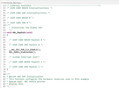

In version STM32U5 1.5.0 ,  HAL_PWREx_EnableVddA() does not exist in stm32u5xx_hal_mps.c
but it was on 1.4.0

Hello @Ghofrane GSOURI  and Thanks for your respond, Actually, I migrated my previous project after update and it does not work and I found this problem. I did not generate a new project.
I have created a new project. but it does not exist in my code.

This issue occurs when the option "Generate peripheral initialization as a pair of '.c/.h' files
per peripheral" is selected .
It has been reported to STM32CubeMX development team .
Internal ticket number: 176661(This is an internal tracking number and is not accessible or usable by customers).
I will keep you posted with updates.
