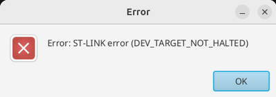

I am using the discovery kit with STM32L562QE MCU (UM2617). I tried to disable the TrutZone following the instructions in this article : https://community.st.com/t5/stm32-mcus/how-to-disable-trustzone-on-stm32u5-series/ta-p/49793
However, after doing Step 3 (in the article), I can no longer interact with my card. When I try to connect to it using STM32CubeProgrammer or by flashing, I always have the same error : ST-LINK error : DEV_TARGET_NOT_HALTED
I found some persons with the same problems :
https://community.st.com/t5/stm32-mcus-boards-and-hardware/st-link-error-dev-target-not-halted/td-p/278454
https://community.st.com/t5/stm32-mcus-boards-and-hardware/error-in-initializing-st-link-device-reason-9-target-not-halted/td-p/85174
But the solutions described do not seem to work for me. Here is what I've tried :
- Power off / Power on
- Update STLink
- Set NRST to high (because there are many NRST on the board, maybe I did not set the right ones)
- Switching to boot mode (same thing than above)
Has anyone an idea on how to solve this problem ?

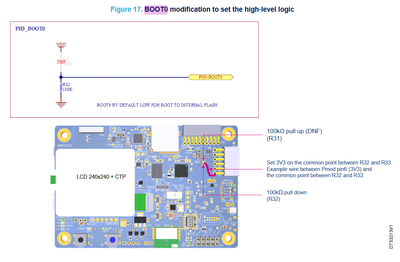

Hello @MaxenceV,
Try connecting in hotplug mode with Boot0 pin at VDD.
Aziz
Just to be sure that we are talking about the same thing. Here is the only reference I found about boot0 in the doc.
After setting, boot0 at 3V3 (I did the same setup as the doc), and trying to connect in Hot plug mode the error has changed. Now I have this :
Hello @MaxenceV,
Yes, that's exactly it for the STM32L5-DK. Just make sure to power off/on the board after linking the two points with the wire as shown in this graph above (the power off/on is to make sure the new boot configuration is applied).
If that's done and you still can't connect via Hotplug mode, I'm afraid the chip is no longer recoverable (Root cause is that you most likely changed non-secure boot address Option Bytes or the nSWBOOT0 option bit).
I suggest for anyone trying to work with Trust Zone to first check this resource before any manipulation:
Introduction to Arm® TrustZone® features on STM32L5, STM32U5, and STM32U3 MCUs - Application note
Aziz
Hello @Aziz BRIGUI,
With adding the power off/ power on part, it worked. I can access my card again.
Thanks a lot for your help.
Have a great day,
Maxence V
