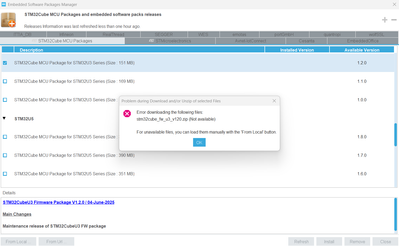

Hey everyone,
I'm currently trying to work with the NUCLEO-U386RG-Q development board.
When I try to download the latest available MCU package (1.2.0) via STM32CubeIDE, I only get an error message stating that the requested MCU package is not available. This is obviously incorrect, as I can manually download and install it from the ST website.

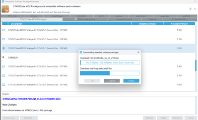

When I try to install one of the previous releases, the connection is established, but the download is extremely slow for some reason.
Other MCU packages, like those for the STM32U5 series, download without any issues and complete within seconds.
I'm using STM32CubeIDE version 1.19 and have already completely reinstalled it. A refresh of the package list also doesn't solve the problem.
Is anyone else experiencing this or knows how to fix it?

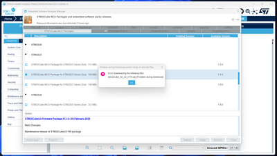

Hey @mƎALLEm ,
thank you for your quick reply, no i tried it right now but i get nearly the same behaviour.

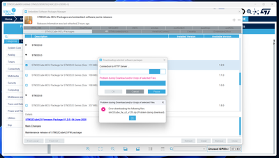

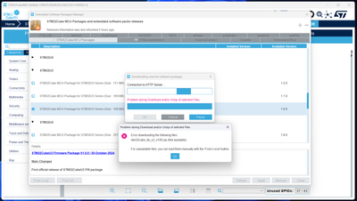

In STM32CubeMx, the MCU-Package versions V1.2.0 and v1.0.0 throw an error when i try to download them :

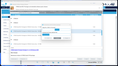

Version 1.1.0 therefore tries to unzip something for some reason and exits after a while with the same error message type:
Other MCU-Packages like the ones for STM32U5 work without any problems as described above.
