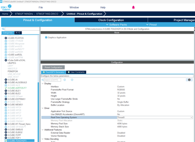

Hello @Abhishekvh76 ,
- You need to install TouchGFX 4.26.0 Designer Software.
- Under X-CUBE-TOUCHGFX, Driver, you select Real-Time Operating System: ThreadX.
- You need to be sure that the folder location path does not include a space.
- Open ApplicationTemplate.touchgfx.part under TouchGFX Folder through TouchGFX 4.26.0 Designer    Software, generate the code and Run Simulator.
- Import the project through STM32Cubeide
- The build will be finished successfully.
You find in attachment the STM32CubeIDE Project with ThreadX and TouchGFX enabled.
I will be waiting for your feedback.
Best Regards.
Mahmoud
