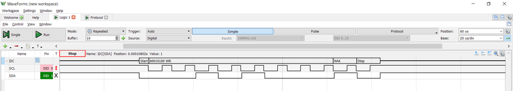

I'll give you a bit more info:
The code:
__HAL_RCC_I2C1_CLK_ENABLE();
MX_GPIO_Init();
MX_I2C1_Init();
HAL_GPIO_WritePin(GPIOB, LD2_Pin, GPIO_PIN_SET);
HAL_I2C_Master_Transmit(&hi2c1, 0x00 << 1, (uint8_t *)"123", 1, 1000);
HAL_GPIO_WritePin(GPIOB, LD3_Pin, GPIO_PIN_SET);
The thing is that when I load the code the board will get stuck and light up LD3 and LD8, same if I reset.
If I comment the I2C code (inizialitation and transmit) the code will load up without a problem.
Daniel
Update:
I've unpluged the nucleo board and plugged it back and it appears that the code runs.
After loading the code it gets stuck, but if you reset the power (unpluging and pluging back) it works, as seen in the image.
I don't know why it gets stuck after loading the code though.
