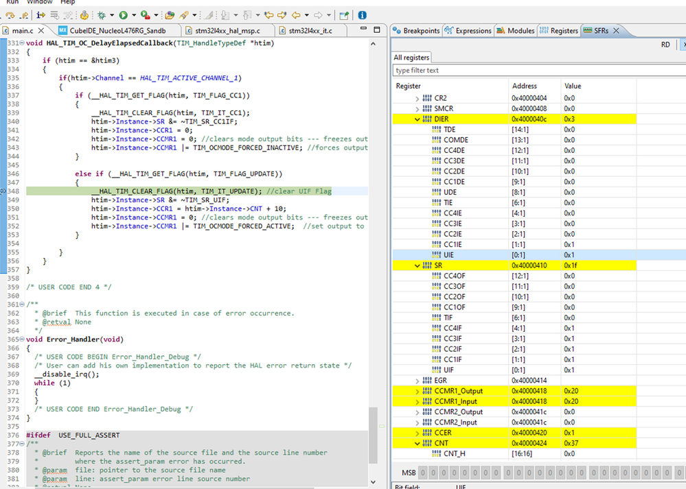

The following below is my ISR.....My attempt was to have UIF interrupt me every 10khz (see above comment on this), turn the output on and arm the CCR with counter + 10. My thought was that after this expires (CNTR clock is 1MHz so my expectation was 10us later) I would get a CC1R interrupt and then clear the output using FORCED_ACTIVE and INACTIVE statements. There are a few things here:

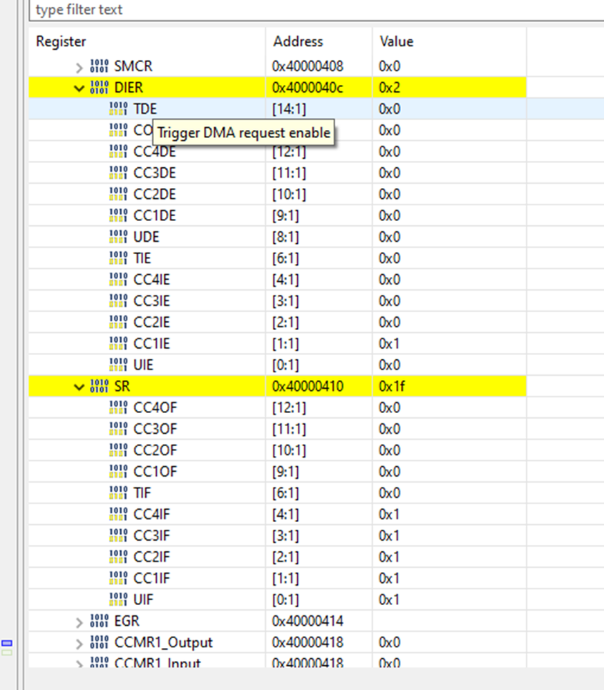

- I notice with breakpoints set neither the macro nor the call after it clear the UIF flag....Why is this??(I have attached pic below showing enables or IRQs set and flags set
- I never get into the CC1 portion of the interrupt...any thoughts as to why?? as the expression solves to a '1'
- Where do I find the various priorities of the flags that can cause an interrupt in TIMER3?? is the UIE higher priority than the CCxE?

If you want to see the flags being cleared, the respective DBGMCU_APB1FZR1 bit to stop timer while debugging, otherwise it will keep running and setting the flags faster than the debugger succeeds to read it out.
The flags in SR are set regardless of whether respective interrupt in DIER is enabled or not. If you want the ISR to handle only the enabled interrupt, you must check which interrupt is enabled and act accordingly. The simplest way is to mask SR with content of DIER (note that position of respective flags matches the bits in DIER, it's no coincidence, it's deliberately designed so this operation can be done easily).

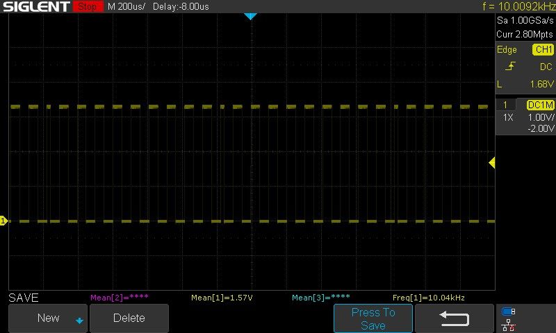

I have attached a very basic test that just isn't working as I would expect. Can someone tell me what I am missing here???? I have reduced the code to 20MHz on APB1, using Timer3, pre-scaler set to 0, period set to 20000 - 1...effectively the clock is 20MHz with an interrupt being generated at 1ms (20000/20MHz). I have programmed the CCR1 register with 1000. This SHOULD give an interrupt every 50us as the compare register only cares about the counter NOT the period setting (20000 - 1). Now what I care about is a "consistent and reliable compare output". I don't care about the 1ms interrupt. Below shows the code as well as a scope image. Notice that every 10th pulse is shorter than the other pulses. The UIE bit is NOT set AND the condition in the ISR should never get encountered when UIF goes off every 1ms, BUT as you can see the UIF flag going off toggles the pin and causes a jittery 10th pulse ie 1ms (20000 / 20MHz). If I change the period to 10000 -1 the jittery pulse moves to 5 apart instead of 10 which just supports that the UIF flag is causing this. How come I cannot get these pulses from STM32 product to be this precise??? (beyond frustrated)....This is as bare bones code as I can do and it still is NOT working....Scope says it all.
Notice ONLY CC1IE enabled.

‎2023-01-02 9:11 PM
> htim3.Instance->CCR1 = htim3.Instance->CNT + 1000;
This does not result in interrupts exactly 1000 clocks apart. CNT keeps counting after the compare happens, so the next CCR1 includes interrupt latency and execution time, so the second CCR1 will be something like 2050, the third 3100, etc.
And when CCRx>ARR, compare thus interrupt happens at Update.

‎2023-01-03 8:00 AM
> uint32_t temp = htim3.Instance->CNT;
Note, that you are still basing your calculation on the CNT, which is counting thus subject to interrupt latency plus execution time from ISR beginning to the point of readout. If you measure precisely, you'll see distance between edges somewhat larger than 1000 counts, maybe 1050 or so.
For precise calculation you would need to advance the CCRx, so it changes as 1000-2000-3000 etc.
Also a minor correction at the rollover: note, that after ARR comes 0, so you want your formula for the (tmp + 1000) > ARR to be (tmp + 1000 - ARR - 1).
