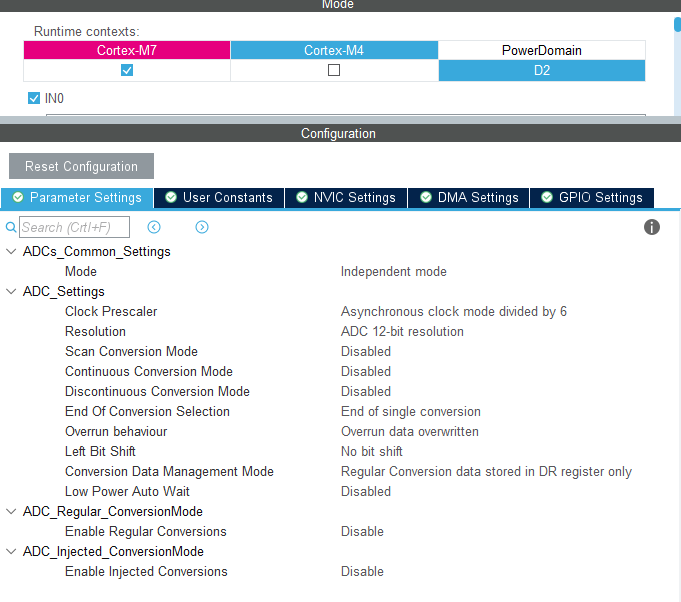

I am currently working with the stm32h747, trying to sample current and voltage using the internal ADC with its analog pins. My samples are wrong, the values sampled are coming out with a wierd offset (for example: 0 voltages is samples as ~1.87v). i can see that aplying votage on the pins or shorting them to GND gives some effect but the values are still wrong.
the init code is standard and generated by cubeMX, My cube defenitions look like this:
0693W00000Hr0AKQAZ.pngHere is an example of how i sample:

the result in calculations will be a float value so i return what the ADC sampled already converted to float variable. but this isnt the problem, the value sampled is already too high to begin with.

i am using ADC1, also i have tried this with 10 different adc inputs (0,1,2,3,4,5,6, 10,15,19)
the mcu is stm32h757, embedded in a custom board.
the issue persists on both STM32H747 disco and nucleo-H745.
While working on the Nucleo-H745 i tried several different analog pins (PC0, PA4, PF11)
The results were:
pin not connected to anything - 1.5-1.6 V
connected to 3.3V - 2.9-3V
connected to GND: 1.2 V
The results variy between pins by 100-200 mV.

Thanks for the responses everyone.
The issue was resolved by changing configuration in the cube and now we are able to read the data properly.
The only thing that is still alarms me that the old configuration which was basic worked on the F7 and did not work on the H7.
