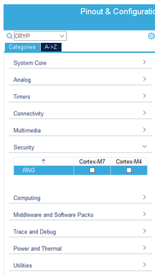

Why is there no CRYP (Cryptographics) peripheral enabling/configuration option in project configurator (CubeMX/CubeIDE) for STM32H747 ? I tried v1.15.0 and v1.16.0
It does not show up:

Hello @mkrk
This is only available for MCUs that feature Cryptographic acceleration (such as the STM32H757 that has exactly the same features but add the Cryptographic accelerator). For the STM32H747, you may can use the X-CUBE-CRYPTOLIB (the one used by the client on the post you mentioned) and include it to your project directly following this article.

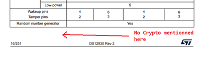

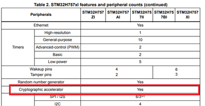

@mkrk wrote:
reference manual is the same for H747 and H757
Here you need to refer to the related datasheet especially "features and peripheral counts" table not to the reference manual as the latter is common to many devices.
H757:
H747:
