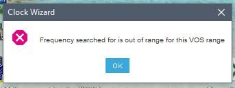

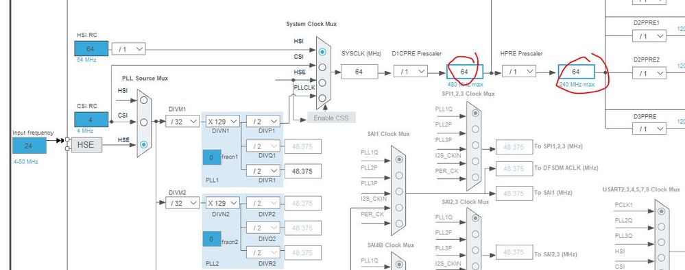

I cannot set the source clock frequency to 480 Mhz
cubeMx gives an error message: "Frequentcy searched for is out of range for this VOS range"
However, the VOS0: scale0 is normally set at 480/240 Mhz

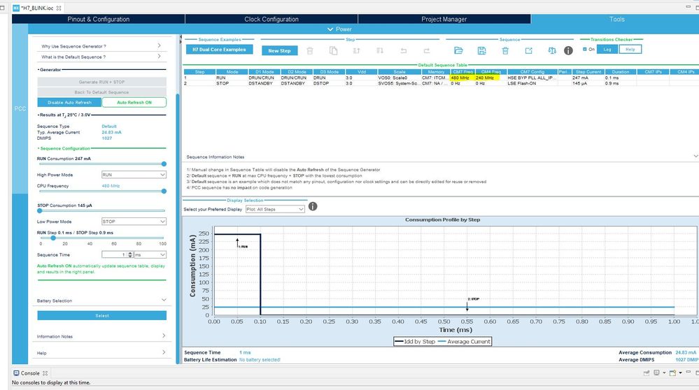

It works with cubeMx 610.0693W000007ZeoYQAS.jpg0693W000007ZeoTQAS.jpg0693W000007ZeosQAC.jpg

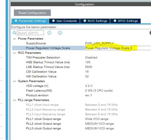

I have found the reason about this problem:
The RCC Power Regulator Voltage Scale is default : Scale 3 !
I have set this to scale 0, and its works
