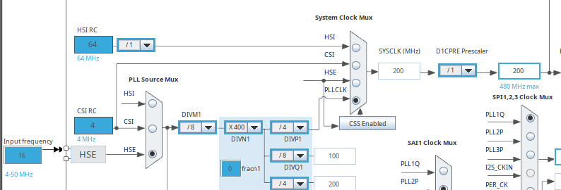

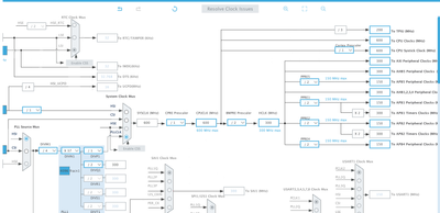

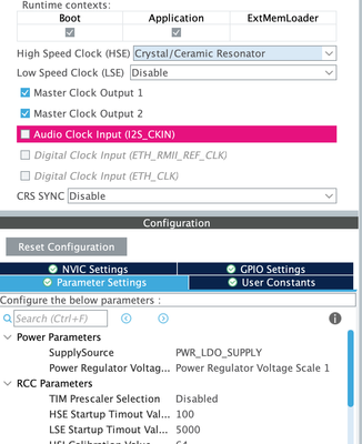

I am using an STM32H7 MCU and configuring the system clock to 400 MHz using CubeMX. The clock tree shows SYSCLK = 400 MHz, and MCO2 is configured to output SYSCLK.
However, when I debug:

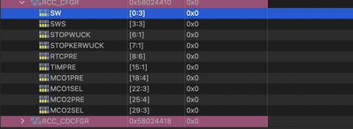

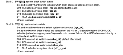

HAL_RCC_GetSysClockFreq() returns 64 MHz
RCC->CFGR shows SWS = 0 (HSI is used)
SW = 0, meaning the system is not switching to PLL
It seems that the PLL is not being selected or is failing to lock, and the system remains on HSI. I have configured PLL and SYSCLK source in CubeMX, but the change is not reflected at runtime.

So set the HSE to the real frequency it has on your board...
then choose HSE on clock tree and dont use the frac /fractional setting.
like this:
