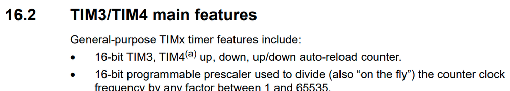

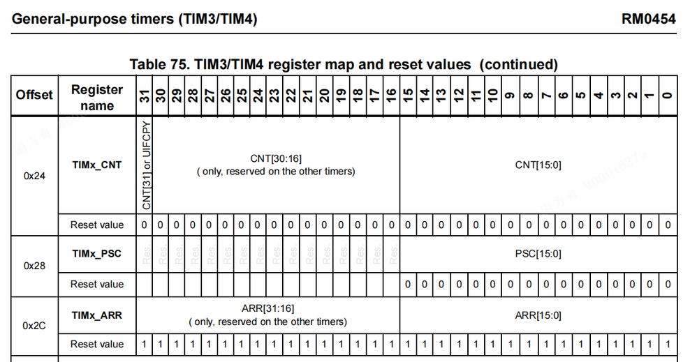

I found the TIM3 of the G070 chip has 32bits Cnt register and ARR register in Reference manual. However, I can only configure the Low 16bits of these registers in STM32CubeIDE which means the max value of these registers is 65535 instead of 2^32 - 1. Why
fhu.11
That doesn't say TIM3 is 32 bit.

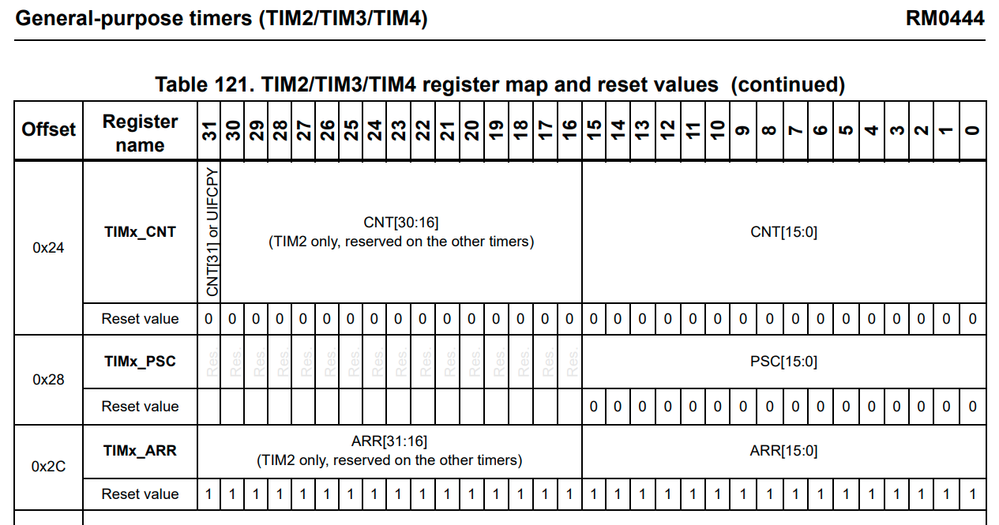

It's actually copy/pasted from the STM32G0x1 reference manual, which has TIM2 (a 32-bit timer) and lists TIM2/TIM3/TIM4 in the same section. However, the STM32G0x0 doesn't have TIM2, so they sloppily removed all references to TIM2 and left inconsistencies like this.
TIM3 is 16 bits.

TIM3 is a 16-bit timer per the reference manual and datasheet.
The CNT register might be 32-bits, but only the lower 16 bits are usable.
fhu.11
0693W00000DnBt7QAF.pngthis is the TIM3 register map which means only TIM3 has 32bits Cnt and ARR register
TIM3 is 16 bits.
