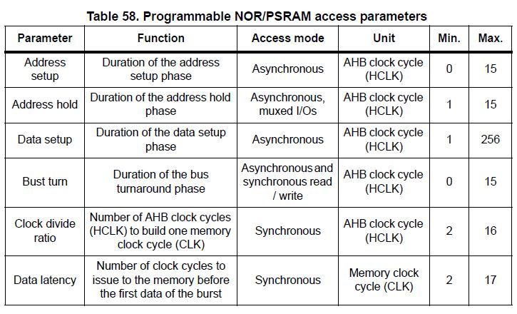

  Timing.AddressSetupTime = 5;
  Timing.AddressHoldTime = 3;
  Timing.DataSetupTime = 5;
  Timing.BusTurnAroundDuration = 0;
  Timing.CLKDivision = 0;
  Timing.DataLatency = 0;
  Timing.AccessMode = FMC_ACCESS_MODE_A;

/* Timing */
Timing.AddressSetupTime = 10;
Timing.AddressHoldTime = 10;
Timing.DataSetupTime = 10;
Timing.BusTurnAroundDuration = 1;
Timing.CLKDivision = 1;
Timing.DataLatency = 1;

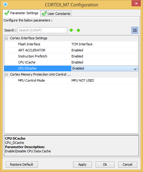

Posted on August 02, 2017 at 15:42
The correct answer i was enabled D and I cache at the same time with accelerator, and it cause this.0690X00000607NhQAI.png
Please CubeMX programmers, produce fail safe CPU parameters, so if one is selected, others could not be enabled !!

'The correct answer i was enabled D and I cache at the same time with accelerator, and it cause this.' ( this and accelerator ??)
when you have the ART Accelerator ON,  D-Cache ON  I-Cache ON, then .. what doesn't work ?
Posted on August 03, 2017 at 13:38
my external 32b SRAM interface does not work, while at the same time, debugger shows that every thing is ok.
It just does not want to generate any hardware signals, same code, commented DI init functions, and viola, works like a charm
Posted on August 03, 2017 at 14:06
Or to be more precise, i can't use //SCB_EnableDCache();, since it will stop my SRAM interface working.
Any ideas why it is happening?
