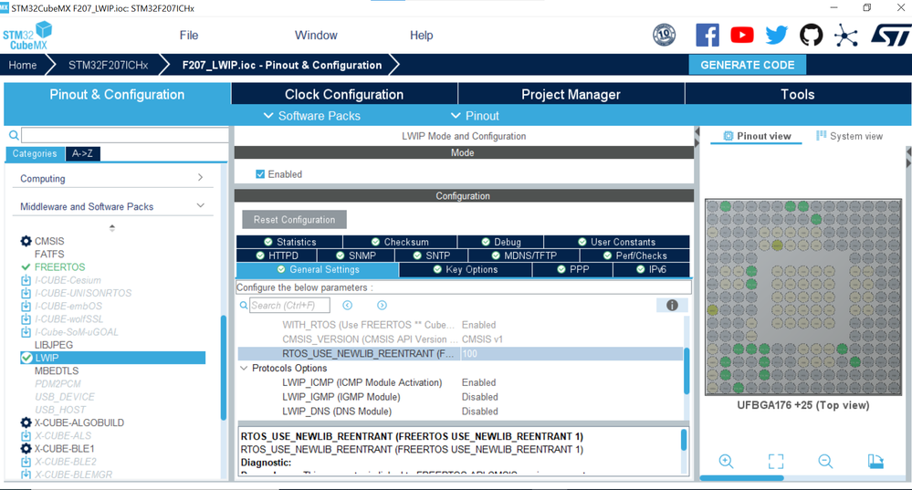

Hello, I have problems configuring a STM32F207 with Ethernet and LwIP and FreeRTOS. I have activated RTOS_USE_NEWLIB_REENTRANT in the FreeRTOS settings but still an error message appears in the LwIP settings. How can I fix this?

I have also checked the error with other chips of the F2xx series, but the error is also there. Does anyone have an idea how I can fix the problem?

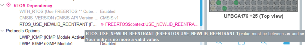

Hello @SKuhr.1
Please have a look:
_legacyfs_online_stmicro_images_0693W00000bigtnQAA.pngAfter Enabling RTOS_USE_NEWLIB_REENTRANT in the FreeRTOS settings you need to give it a value .
Thx
