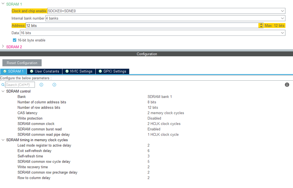

I run an application with stm32f429zg using freertos. An external 8Mb SDRAM from winbond (W9864G6KH-6) is used with fmc protocol.
I set timing settings in stm32cubemx based on the sdram datasheet.
The common clock of sdram is 72Mhz. All other settings can be seen below:
The sdram initialization code can also be seen below:

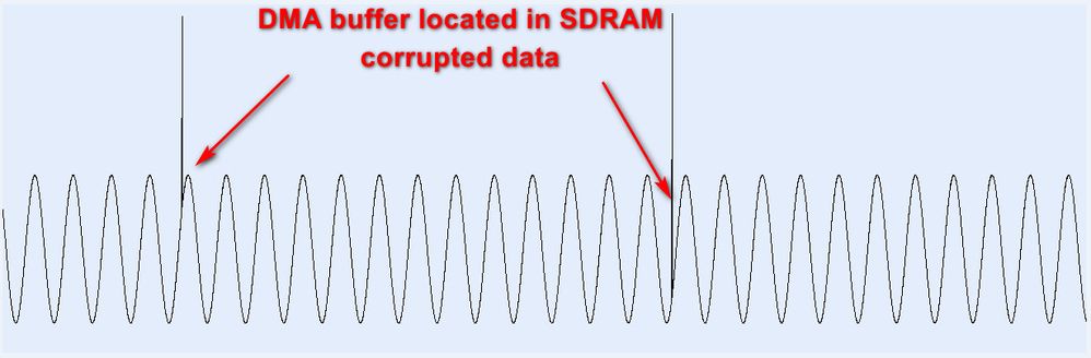

I define a uint8_t array (about 50kbytes) in sdram and use it in dma spi receive. This buffer that contains samples of a 50 Hz sinusoidal waveform is written by dma about every 125us. After the completion of dma data receive, it is processed by another task.

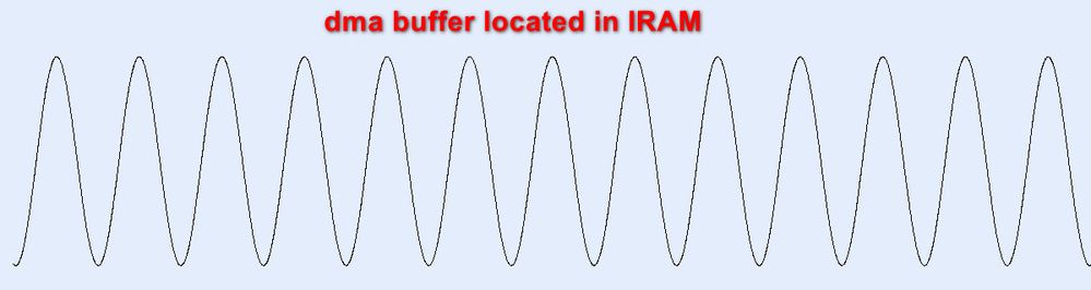

One problem I have is that sometimes data stored in the sdram become corrupted. For example, I see some unusual and invalid surge in the waveform. It means that some bytes of buffer in the external sdram are corrupted. When I define this buffer in the internal MCU ram all things go well and there is no corruption.
When I change some config like sdram timing or refresh rate or CAS latency, the corruption rate is also changed, but I couldn’t have a complete valid samples yet.

hi, I found the same problem. I capture GPIO data triggered by TIM8_CH1 to buffer in DMA mode. When I locate the buffer in internal ram, all data are correct. But when I locate the buffer in SDRAM, occasional Data Corruption will occur randomly.
