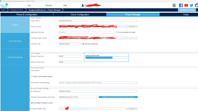

I am trying to "generate code" using an existing .ioc file. When I click on "generate code" , it is stuck. I am not able to close the window. I had to restart my laptop. I uninstalled and installed again. Tried the same process. But it didn't work. Need help.

I was able to sort out the issue. There was an "&" in my folder name that i was trying to save the file. Once i renamed the file i was able to generate the code. Thanks for the reply.
