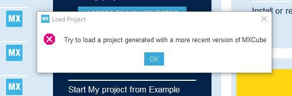

As a long time bare metal and STM32 Std Library user, I am trying to brush up my skills to use the HAL interface (and other things). Using STM32CubeMX V6.2.0, from the New Project from Example form, I double clicked on the example UART_ReceptionToIdle_CircularDMA and it downloaded a project. When I try to open the example it just gives the message "Try to load a project generated with a more recent version of MXCube". This happens with some other USART examples, for example UART_Console.

Hi again @sm23​
According to the image shared, the 6.2.0 CubeMX version is not installed in your machine (or maybe an error has happened during the upgrade), and these 4 examples requires the latest CubeMX version and consequently the latest CubeFW version for the G4 and L5 projects, and that's explain the NOT FOUND message error that you have faced :
0693W000008wx1QQAQ.pngPlease follow steps below to solve your problem:
*/Uninstall your current CubeMX version
**/Install the latest CubeMX version from site
***/Open Example Selector ( you will not find the download icon beside the 6.2.0 version this time)
In case when the FW version is not present, it will be automatically installed when you start your project. (If you still face a problem please attache your .log file under C:\Users\login\.stm32cubemx)

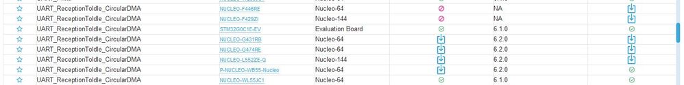

From the main window of STM32CubeMX select "Start Project from Example". From "Example Selector" screen Enter keyword UART/USART. In the list of examples I get these 8 possible CircularDMA examples as shown below.
I am going to select #7 because that saysSTMCUbeMX Version 6.2.0. So that is P-Nucleo-WB55-Nucleo.

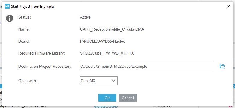

Then I get this dialog
Then I click okay and it seems to download some files, then it takes me back to the STM32CubeMX main page and displys this message:

Khouloud ZEMMELI
Hi again @sm23​
Hope my answer helped you, when your question is answered, please close this topic by choosing Select as Best. This will help other users find that answer faster.
Thanks for your contribution, Khouloud
sm23
Hi Khouloud
Thank you for your reply.
I had not understood the need to completely replace the installed version of the program. As I am trying to work on actual projects using the processors that I do have and take inspiration from small snippets of code showing a particular technique, rather than actually run them as I don't have the hardware, this is not going to work for me.
I had expected something more along the lines of the examples available for the Standard Peripheral Library which can just be downloaded by my IAR IDE. The problem with the HAL-style examples available through the IAR IDE is that they use HAL but not STM32Cube and don't structure the projects the same way.
Oh well.
