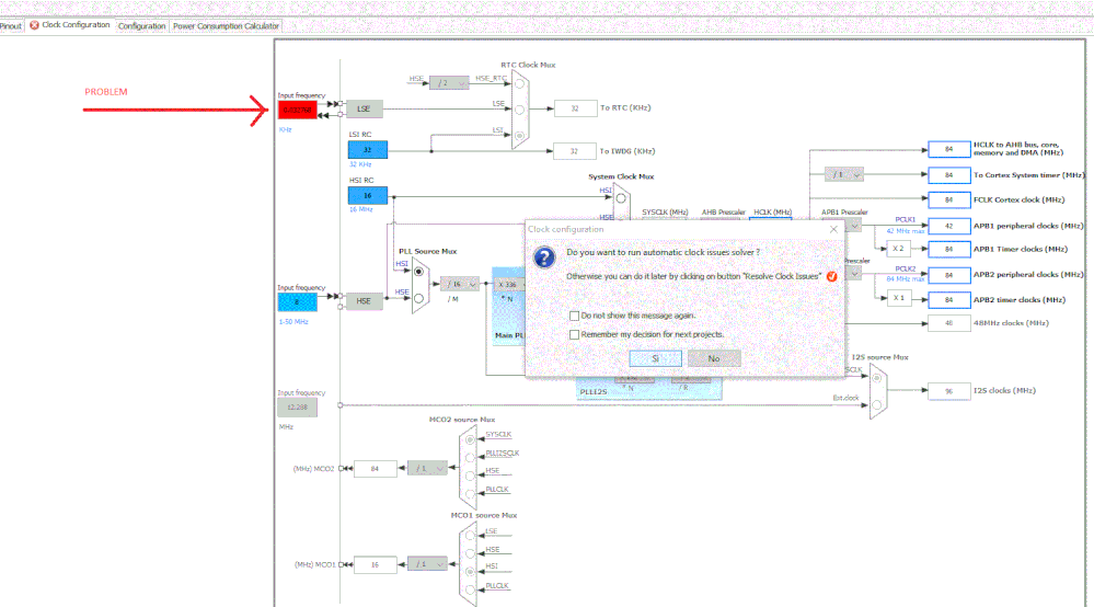

The problem: in the PLUGIN version, by setting the HSE clock in MHz it is rewritten wrong as '0.000000 .....'. For example: I write 8 MHz, press ENTER, the writing becomes 0.0000080. Obviously this generates an error and the 'Input Frequency' box turns red. If I press the 'Resolve Clock Issue' button, after a few minutes it stops and writes 'Can not found a solution for some constrain'. If I repeat the same operations on the 'standalone' version everything works properly, if in HSE I write 8 MHz it remains written with that value.
Steps to reproduce the defect:
Open TrueSTUDIO, start STM32CubeMX plugin (inside trueSTUDIO).
New project.
Part number search: STM32H743ZI
Click on the MCU on the right down. Then 'Start Project'.
In the PINOUT select RCC, set the High Speed Clock (HSE) to: 'Crystal/ceramic resonator'.
Go to Clock configurator. You can see on the left HSE Input Frequency: 25 MHz, blue background. It's OK.
Click on the box under 'Input Frequency HSE', delete 25 MHz and type: 8
After pressing ENTER the box turns red and the writing becomes 0.0000080
If you switch System Clock Mux on PLLCLK you will see that all the subsequent calculations are wrong, there is no way to restore the correct values even by pressing the 'Resolve clock issue' button.
As I wrote before, if you take the same steps on the standalone version, everything works regularly.

‌,thanks for rising this issue, it will be fixed next eclipse plugin version but unfortunately I could not give a delivery date, I will keep you informed

yes it has been reproduced and is a known bug to be fixed in the new eclipse plugin

I've the same problem using the plugin STM32CubeMX 4.0 and Atollic TrueStudio STM32 9.0.1.
I have two PC with Windows 10 installed. The one with italian language has the problem but the one with english has not. Another PC with Windows 8.1 ( italian language ) shows exactly the same issue.
Very strange.
NewProject-><Board selector>->NUCLEO-F401RE->Clock Configuration
Result :
The automatic issues solver doesn't fix the problem.

I've installed the new version of the eclipse plug-in but the result is the same.
The installed plug-in is version 4.26.
