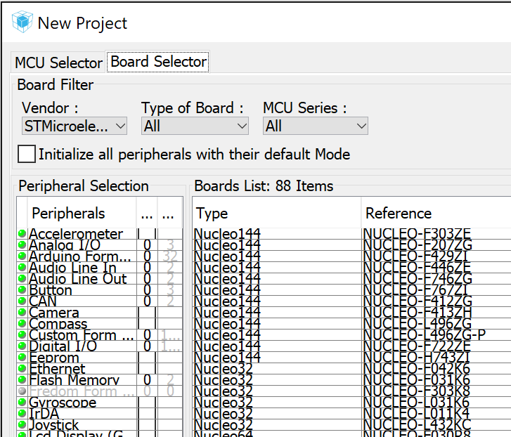

Using STM32CubeMX version 4.18.0 on Windows 10 Pro (build 1607) with an UHD (4K) display results in tiny toolbar icons and a very tiny Clock Configuration diagram.  Please see attached screen capture image.  Not that this application window is not maximized.
Is there any way to scale these images within the STM32CubeMX application so that I can see them with human eyes?

This is a screenshot from my CubeMX application which is currently at 4.22.0. What I and the community would like to know is when this issue will be fixed because while it is usable, it is not optimal.
Is this issue able to be fixed? Is it a problem with the underlying Java libraries? The community would like answers and explanations.
If the problem is within the CubeMX application itself, it should not be difficult to fix I would imagine. If the problem is within the Java UI libraries then this should be communicated.
Are there any plans to open source this application, to place it on GitHub and maybe a few members of the community can pitch in and fix the problem.
Thank you for your time.

The problem stems from the inability for the Swing API (The Java library that handles the GUI) to properly scale the controls to fit the text. While <CTRL> + Mousewheel does solve the issue to some degree, the individual elements within the clock configurator don't scale properly.
If you look at my post above, you will notice that the dividing lines for the board list don't scale properly to fit the text which makes it difficult to read. I do have a solution which works that is detailed further down. This is a rather drastic approach and consequently affects all java applications.

This is my workaround on a Windows 10 laptop.
  1. Right click STM32CubeMX launcher on the desktop and select Properties
  2. Open 'Compatibility' tab
  3. Check ''Override high DPI scaling behavior'
  4. Select 'System' from the combobox and click OK.
Now CubeMX should be lot more readable on a high resolution display.
