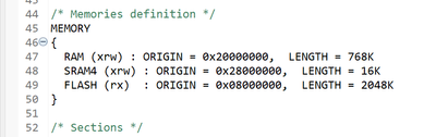

We appear to be experiencing a severe code generation bug with CubeMX. After naming and sizing application regions in the memory management tool, what used to generate a correct linker script now generates bad output.
Upon generation the linker script STM32U575XX_FLASH.ld now shows:
/* Specify the memory areas */
MEMORY
RAM (rwx)      : ORIGIN = 0x20000000, LENGTH = 768K
FLASH (rx)      : ORIGIN = 0x08000000, LENGTH = 2048K
/*start of MX regions Auto-generated By STM32CubeMX*/
RAMBK (rw)      : ORIGIN = 0x20000000, LENGTH = 768K
RAM4 (rwx)      : ORIGIN = 0x20000000, LENGTH = 768K
SPIFLASH (rwx)      : ORIGIN = 0x08000000, LENGTH = 2048K
/*end of MX regions*/
Given that we cannot downgrade the IOC and have performed more work this is an awkward situation and we will manually manage regions in the meantime. This was not an issue before. Please advise what may be going on.

@TDK Not sure what you mean. CubeMX absolutely regenerates the linker script with user-provided application regions. Notice:
We have isolated and reproduced this issue.
The problem is when regenerating the ld file. We took these steps
1. New ioc without any code generated (attached)
2. Generate code
3. Check .ld file, no issue looks good.
4. Generate code again
5. Corrupted .ld file.
6. Manually delete the .ld file in the project directory
7. Generate code again
8. Check newly generated .ld file, looks good again.
Please confirm issue replication.
In summary, first generation of a new file:
MEMORY
RAMBK (rw)      : ORIGIN = 0x40036400, LENGTH = 2K
SRAM4 (rwx)      : ORIGIN = 0x28000000, LENGTH = 16K
Every subsequent regeneration of the same file with no changes then shows this:
MEMORY
SRAM4 (rwx)      : ORIGIN = 0x20000000, LENGTH = 768K
