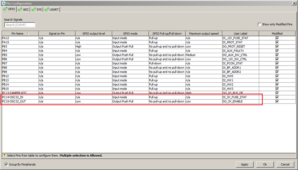

Pins have been preconfigured via Pin Configuration menu in the CubeMX app the following way:
  • PC14 as Input with Pull-Up
  • PC15 as Output (push-pull) with Low Initial State
Here is the code generated for MX_GPIO_Init() function with my comments added:

As you see, the DO_5V_ENABLE_Pin ends up HIGH after initialisation although STM-code tried setting it LOW in the beginning.
Why?
Because the GPIO_InitStruct structure is re-used for each pin being configured but not all fields are initialised all the time.

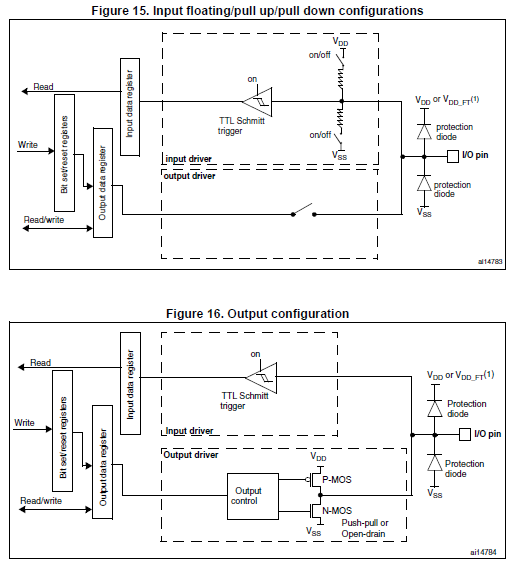

However, I think that your suggestion that "Even in output mode, you should be able to set the pull value" is sort of contradicting the hardware description of the output configuration. The 'STM32F10xxx Reference Manual (RM0008 Rev 19)' clearly says that "When the I/O Port is programmed as Output: The weak pull-up and pull-down resistors are disabled." (p.163). In addition, Figure 16 (Output Configuration) does not show any pull-ups or pull-downs in comparison to the Figure 15 (Input configuration):
So, from programmer's point of view, configuring pull-up/pull-down for output looks a bit strange and unnecessary. However, it should be made clear that GPIO_InitStruct->Pull is actually defining the active output state of the pin (High or Low) if that pin has been defined as an Output earlier.
