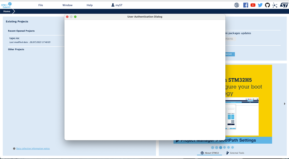

stm32cubemx fails to download packages due to inability to authorize at "myST->login".
According to the crash dump it has happend because of jxbrowser plugin-7.30.2 (chomium version 108.0.5359.215).
All extended attributes had been cleared (not trusted software etc), all neccessary execution bits are set, firewall is turned off.
Please see the log below.
Could anybody help me? Is there any other way to autorise the app?

11:41:50.030 ERROR Chromium process exit code: 137
11:41:50.031 ERROR Crash dump dir: /Users/dimmorpheus/Library/Application Support/JxBrowser/7.30.2/CrashReports
2023-07-27 11:41:50,032 [ERROR] WebApp:339 - JxBrowser engine crashed! Exit code: 137

Of course I have X11 or whatever Ubuntu 20.04 provides as such. However, libx11-xcb1 needed to be installed, that is not a dependency listed anywhere, AFAIK.
Now we are one step further, now Chromium crashes when I click on any login field. That is, I get a login window, and when I click to enter my username, I get the "Aw, Snap!" screen with Error code: SIGTRAP.

Hello @scaprile
It seems JxBrowser now starts and executes some commands. However, there is still an error regarding the missing OpenGL library.
libGL.so.1: cannot open shared object file: No such file or directory
Could you please install it and see if the issue persists?
Thank you Ghofrane,
I added some other missing dependencies and got it to work now.
It still crashes on first try but the reload button works and I can login. Please find log and crash attached.
For the record, this is the list of libraries (Ubuntu 20.04):
libswt-gtk-4-jni libswt-gtk-4-java dbus-x11 libsm6 libusb-1.0 libncurses5 libnss3 libdrm2 libgbm1 libudev1 libx11-xcb1 libxcb-render-util0 libxcb-randr0 libxcb-shape0 libxcb-xfixes0 libxcb-sync1 libxcb-icccm4 libxcb-keysyms1 libxcb-image0 libxcb-util1 libxcb-xkb1 libxkbcommon-x11-0 libkmod2 libgl1-mesa-glx
