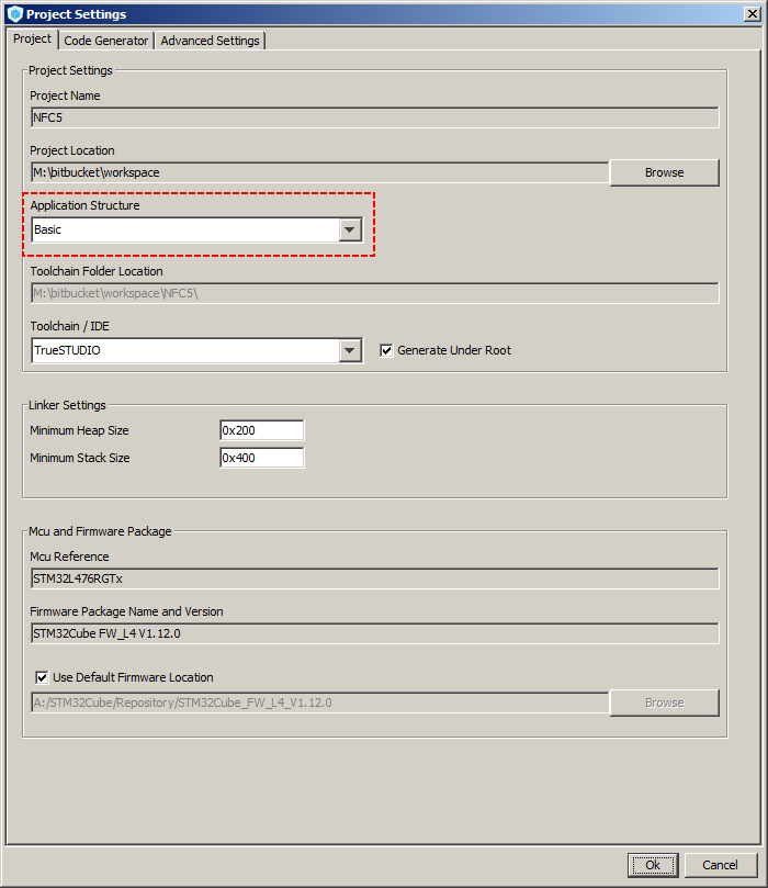

Application structure in CubeMX
In CubeMX 4.26.1 one can find the following combobox:
I tried to find something about it in the CubeMX documentation but in vain. What does it do?

It changes the layout of the files in the project - as in, where it puts Src and Inc folders.
gregorylakewood
From UM1718 Rev 28 4.7.1
Basic structure: recommended for projects using one or no middleware. This structure consists in placing the IDE configuration folder at the same level as the sources, organized in sources and includes subfolders
Advanced structure: recommended when several middleware components are used in the project. It makes the integration of middleware applications easier
