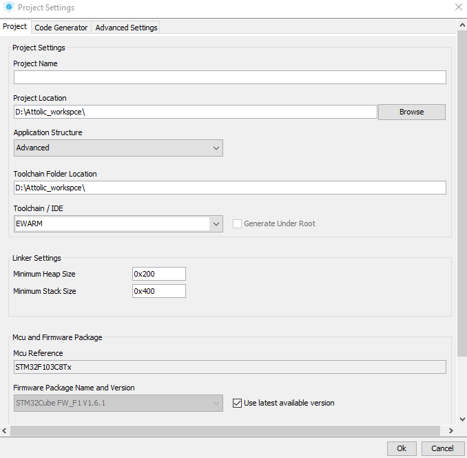

When I am generating Code with CubeMX, it will delete my complete Src folder. I always have to recover it. For that reason it will also not generate any new c files once i add a new peripheral.
Tried this on Mac and Windows with latest CubeMx version (4.26.1) and i get the same behaviour in both.

Hi, I notice that in "Settings" one can select in Application structure "Basic" or "Advanced". The first one erase src, the last one not erase src located in Core folder. Hope help someone. I use CubeMX v4.26.
