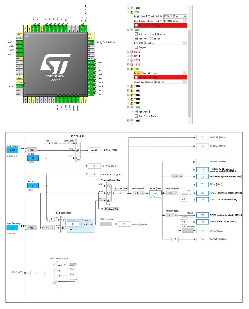

STM32CubeMX Bug?
lz12345zry
Posted on March 28, 2018 at 18:33
Keil  5    uVision V5.14.0.0
void HAL_RTC_MspInit(RTC_HandleTypeDef* rtcHandle)
if(rtcHandle->Instance==RTC)
/* USER CODE BEGIN RTC_MspInit 0 */
/* USER CODE END RTC_MspInit 0 */
                                                                                                      LL_PWR_EnableBkUpAccess();
/* Enable BKP CLK enable for backup registers */
                                                                                    LL_APB1_GRP1_EnableClock(LL_APB1_GRP1_PERIPH_BKP);
/* RTC clock enable */
__HAL_RCC_RTC_ENABLE();
/* USER CODE BEGIN RTC_MspInit 1 */
/* USER CODE END RTC_MspInit 1 */
Build Output:
compiling rtc.c...
../Src/rtc.c(100): warning: &sharp223-D: function ''LL_PWR_EnableBkUpAccess'' declared implicitly
../Src/rtc.c(102): warning: &sharp223-D: function ''LL_APB1_GRP1_EnableClock'' declared implicitly
../Src/rtc.c(102): error: &sharp20: identifier ''LL_APB1_GRP1_PERIPH_BKP'' is undefined
../Src/rtc.c: 2 warnings, 1 error

Imen.D
Posted on March 29, 2018 at 18:00
Hello
Renyuan.Zheng
This is knownissue already reported to CubeMx team for fix in coming releases.
Sorry for the inconvenience it may bring.
Best Regards,
Imen
Thanks
Imen
