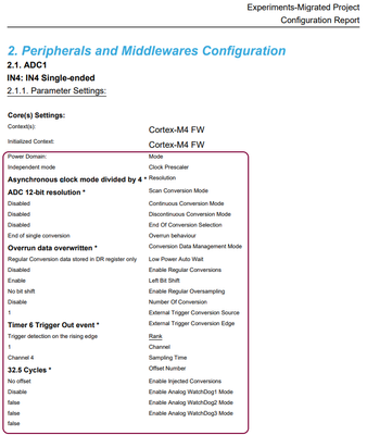

The otherwise excellent STM32CubeMX tool has a bug in its Configuration Report output (reached via the File > Generate Report command). In the Peripherals and Middlewares Configuration section of the report, the left and right columns of the output are reversed or (more likely) line-wrapped.
See attached screen shot for an example -- this continues for many pages.
I could not find a better way to report this, so could the developer of this STM32CubeMX tool please to look into this issue, because it makes the report output very awkward to interpret.
Note that the STM32CubeIDE suffers from the same problem; it probably uses the same report generator.
Thanks in advance on behalf of all your customers.
-- David Adams

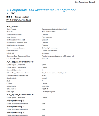

Hello @tarmasr, welcome to ST Community,
This is really strange, as I usually use the report output and never encountered this! Also, am not able the reproduce the same issue

Thanks for both your replies. I have checked the PDF on various PDF viewers: Microsoft Edge, Brave, SumatraPDF, and even on macOS Preview, and the result remains as in the screenshot.
My guess is that it has to do with the default paper format. On my systems, the default paper size is A4, which is narrower than the US Letter format. Did you both use US Letter format by any chance?

Personally, I just use A4 and it works fine.

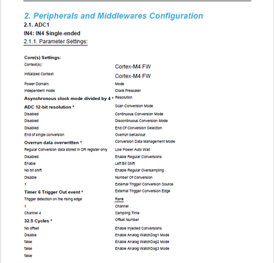

It still doesn't explain why the output gets wrapped onto the next line in all my output; there is nothing unusual that I can see. Compared to @Sarra.S 's sample output the problem starts right after "Power domain:" and then seems to stay out of sync.
Even the "Asynchronous clock mode..." phrase, which really is a configuration value, is being formatted as a subheader instead of a value.
Name/values get out of sync after "Power domain:"Name/values get out of sync after "Power domain:"
It looks as if the bit after "Power domain:" causes the trouble: it is followed by "mode" as well as "Independent mode".
My new guess is therefore that the label should have been "Power domain mode:" followed by its value "Independent mode", but that the label got split into two parts, inadvertently creating a spurious value of "mode", and thus creating a one-off displacement for each subsequent label and value.
@Sarra.S 's output contains no "Power domain:"; @Issamos does yours?
Cheers,
-- David
tarmasr
In an attempt to reproduce this issue, I am attaching the .ioc file that the problematic report was generated from. This is also hosted on a public github repository, so there are no confidentiality issues.
@Sarra.S  and @Issamos , would you be so kind to see if a report generated from this project file on your own systems does reproduce the off-by-one columns, starting from the "Power domain:" configuration item?

Hello @tarmasr
Using your .ioc file, I've got the same issue.
@Sarra.S can you confirm this issue and report it to the conserned divion in ST so it can be fixed.
Thanks again for your feedback @tarmasr .
