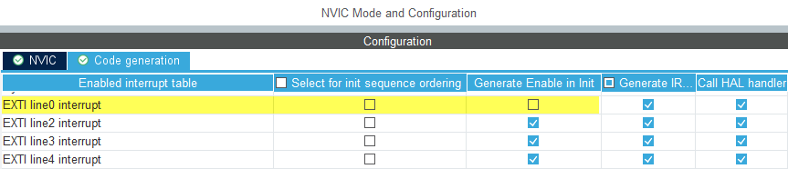

When attempting to initialize a single GPIO EXTI as disabled, the generated code still enables the interrupt. I did notice that if I uncheck all of the EXTI lines, then none of them are enabled in the generated code. So it seems it's all or nothing. Is this the expected behavior?
Thanks,
Frank
This:
0693W00000QLTFGQA5.pngGenerates:
  /* EXTI interrupt init*/
  HAL_NVIC_SetPriority(EXTI0_IRQn, 5, 0);
  HAL_NVIC_EnableIRQ(EXTI0_IRQn);
  HAL_NVIC_SetPriority(EXTI2_IRQn, 6, 0);
  HAL_NVIC_EnableIRQ(EXTI2_IRQn);
  HAL_NVIC_SetPriority(EXTI3_IRQn, 6, 0);
  HAL_NVIC_EnableIRQ(EXTI3_IRQn);
  HAL_NVIC_SetPriority(EXTI4_IRQn, 6, 0);
  HAL_NVIC_EnableIRQ(EXTI4_IRQn);

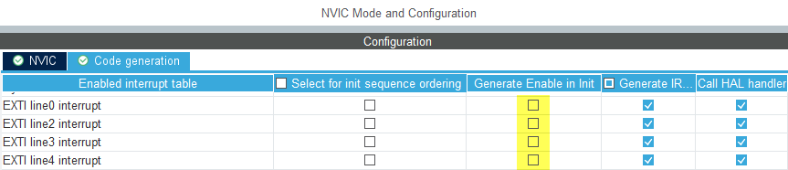

However, this:
0693W00000QLTFfQAP.pngGenerates:

This is a known issue and it is already raised to the dev team. When "Generate enable in init" is unchecked, its respective HAL_NVIC_EnableIRQ(XXXX_IRQn) should not be generated.

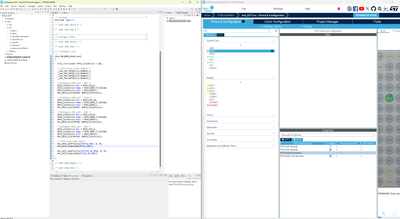

The problem still exists in CubeMX Version V6.16.0. With STM32L496 and "generate peripheral initialization as pai of .c/.h files per peripheral" checked
Hello @lbrosen
I performed a test using STM32CubeMX 6.16.0 and STM32CubeIDE 2.0.0 and it's working correctly.
Could you please retest using a from scratch IOC?
