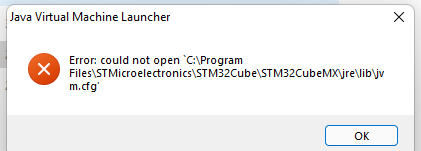

STM32CubeMX 6.4 not start in windows 11 ! I tried to put this file in that folder but the STM32CubeMX program doesn't start

I had to install the STM32CubeMX version 5.6.1 and then doing various upgrades I was able to make it work with 6.4

Hi @michelemancini2​ ,
Thanks for your feedback,
I tested the CubeMX latest version 6.4.0 on Windows 11 and I didn't face any issue during the install nor during the launch. It works perfectly on my side.
The issue that you faced seems to come from Java, Anyways I am very glad that you found a way to make STM32CubeMX 6.4.0 work on your computer.

PVed.1
I had the same problem on Windows 11. Any version of CubeMX could not start.
I created a new Windows user and deleted the old one. It helped me
