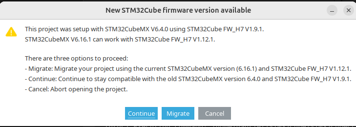

I have an ST32CubeMX project for a STM32H7 mcu generated with STCubeMX 6.4 and using STM32Cube FW_H7 V1.9.1 where the project files are generated via cmake. Now I want to use STM32Cube FW_H7 V1.12.1, but apparently, in order to be able to generate the new files, I have to migrate the project to STM32CubeMX 6.16.1:

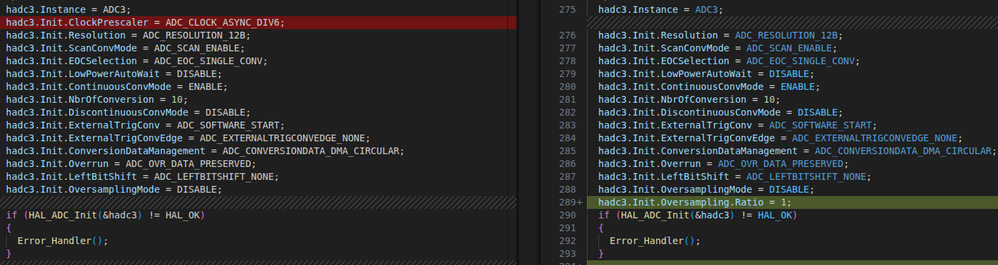

The problem is that, once I click in "Migrate", it removes two important lines from my code:

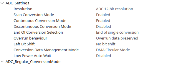

So, I went to CubeMX to check, and apparently, at a first glance, the field to configure ADC3 Prescaler is gone ( I do not have any other ADC on):

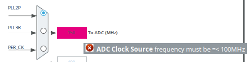

Also, the clock configuration tab was showing a problem. I went to check and apparently ADC clock is not allowed to be more than 100 MHz anymore:
Unfortunately, I can not slow PLL2P down, since it is used for other peripherals (e.g. SPI), but I could maybe change the clock source to PER_CK and then derive it from HSI to have it as 25 MHz ( 150 MHz + Prescaler of 6 ), although I do not know which other implications it could have.

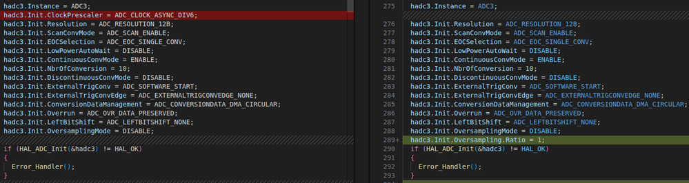

Thank you, the missing field in ADC configuration is indeed back, but the code generation still deletes this line from my project and does not generate a new one:

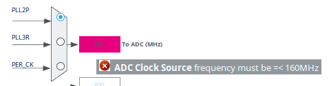

The previous limit was 160MHz as it can be seen below:
Is it an error from the new version or was it an error before that was corrected now?

Hello @gsilva_bretgeld_eng
Further to your last comment, I confirm that the clock prescaler code line is not generated on static void MX_ADC3_Init(void).
The issue has been submitted to the dedicated team under this internal ticket (Ticket Number: 227955)
You can notice through the Reference Manual, Table 60. Kernel clock distribution overview, that the Maximum allowed ADC Frequency is 100 MHz for Power Regulator Voltage Scale 0 or 1 and 80 MHz for Power Regulator Voltage Scale 2 or 3.
I will be waiting for your feedback.

Hello @Mahmoud Ben Romdhane
I see, you are right, so it was a previous mistake that was fixed in the newer versions. I will adjust that on my projects and then wait until the MX_ADC3_Init is fixed. Should I mark "Accept as Solution" then?
