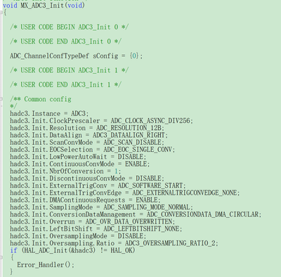

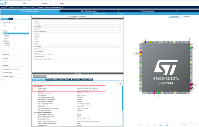

In the STM32CubeMX configuration interface, there are two identical options here.
They can be configured into different options.
After generating the code, it will be based on the configuration of the second option.

Hello @istery
This issue is fixed in the STM32CubeMX version 6.16.0 which is published on ST website.
