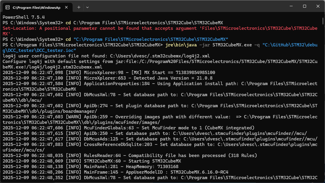

I would like to automate code generation of my .ioc file using CubeMX from command line or PowerShell.
AI says its possible with the -q (quiet mode) option but it does not seem to work.
What version are you using?
Please show the command you actually used, and the results you got.

Here is what I get:
Dumps a lot of *** ... opens the CubeMX IDE ... which I do not want ... does nothing no code generated!

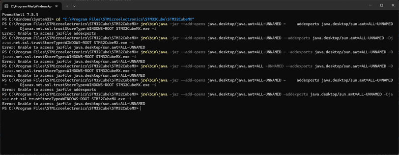

So I tried to launch in interactive mode copying the line from UM1718
I get:
Tried several variations assuming it was the CR/LF in copy/paste causing problems ... sill cannot get it right.

I know the .ioc file at C:\GitHub\STM32\debug\DCC_tester\DCC_tester.ioc is perfectly valid as I can just click on it in Windows Explorer and CubeMX launches and loads it just fine.
I created a simple script named CubeMXGenerateCode.txt with the following two line:
config load "C:\GitHub\STM32\debug\DCC_tester\DCC_tester.ioc"
exit
I placed it in the same folder as my other project and .ioc files.
Tried to launch it with:
I get:
dump window:
Hello @dvescovi
It seems that your IOC is corrupted or you tried to open it with a non-compatible version. Could you attach your ioc to investigate the problem?
Otherwise, to generate code you should add a line in your script as bellow:
generate code <path>
Duh .. as I stated before "I know the .ioc file at C:\GitHub\STM32\debug\DCC_tester\DCC_tester.ioc is perfectly valid as I can just click on it in Windows Explorer and CubeMX launches and loads it just fine."
