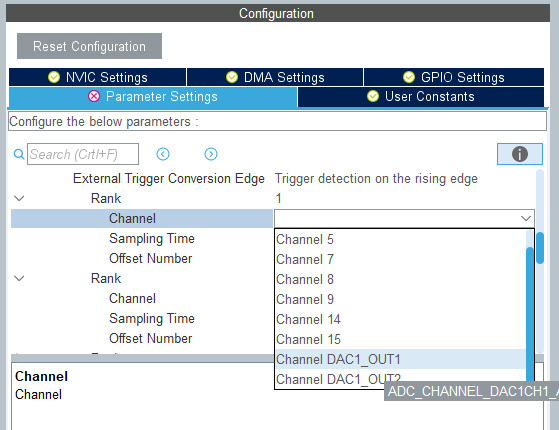

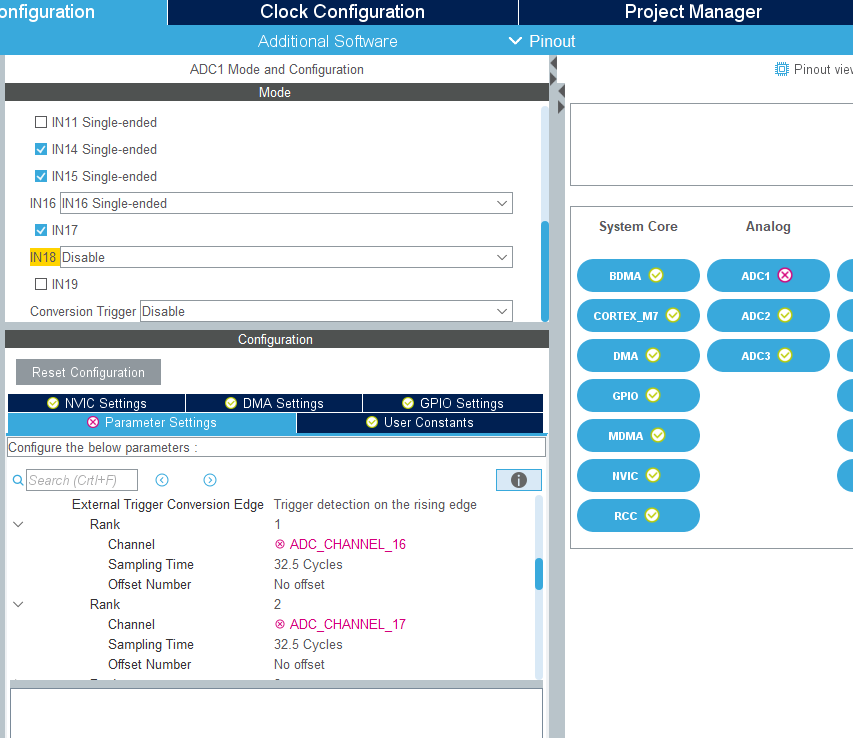

I recently migrated from STM32CubeMX 5.1 to 5.2 and immediately noticed a "error" in my ADC 1 configuration. It turns out that although I can still select Channels 16 and 17 as single-ended analog inputs from the mode and system-view windows, Cube doesn't give the option for selecting them in the "rank->channel" drop down and instead errantly gives DAC_OUT_1 and DAC_OUT_2 as selection options (See images).

Hardware: STM32H743IIT6
Embedded Software Package: STM32H7 1.4.0

@Martin Franke​ Issue will be fixed in the next release.
