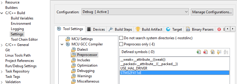

Since the last update to CubeMX, new projects created for SW4STM32 on OSX are not compiling anymore. The project settings for C symbols are missing quotes:
__weak=__attribute__((weak))
 instead of __weak='__attribute__((weak))'
__packed=__attribute__((__packed__)) instead of __packed='__attribute__((__packed__))'
#stm32cubemx
Posted on December 12, 2016 at 06:55
Yes, and if you are using Eclipse, you can fix this in:
C/C++ Build
Settings
MCU GCC Compiler
Symbols

David Bourgeois
Posted on December 12, 2016 at 07:42
Thanks, that's what I did. Is it the right place here to report such bugs?

Posted on April 11, 2017 at 08:00
It seems to be still buggy in version 4.1(Winx64, Eclipse Neon 3)
For both compilers (gcc ang g++) the __weak and __packed symbols are defined without quotes:
As a result for c-files the gcc compiler is working fine
Invoking: MCU GCC Compiler
%cd%
arm-none-eabi-gcc -mcpu=cortex-m4 -mthumb -mfloat-abi=hard -mfpu=fpv4-sp-d16 -std=c11 '-D__weak=__attribute__((weak))' '-D__packed=__attribute__((__packed__))' -DUSE_HAL_DRIVER -DSTM32F411xE ...
Finished building: .../RosRobiF4/Middlewares/Third_Party/FreeRTOS/Source/croutine.c�?�?�?�?
whereas for cpp-files the g++ compiler is failing
Invoking: MCU G++ Compiler
%cd%
arm-none-eabi-g++ -mcpu=cortex-m4 -mthumb -mfloat-abi=hard -mfpu=fpv4-sp-d16 -std=c++0x -D__weak=__attribute__((weak)) -D__packed=__attribute__((__packed__)) -DUSE_HAL_DRIVER -DSTM32F411xE ...
/usr/make/sh: -c: line 0: syntax error near unexpected token `('
/usr/make/sh: -c: line 0: `arm-none-eabi-g++ -mcpu=cortex-m4 -mthumb -mfloat-abi=hard -mfpu=fpv4-sp-d16 -std=c++0x -D__weak=__attribute__((weak)) -D__packed=__attribute__((__packed__)) -DUSE_HAL_DRIVER -DSTM32F411xE ...
make: *** [Application/User/Common/Communication.o] Error 258
Obviously the g++ compiler needs the quotes ...
