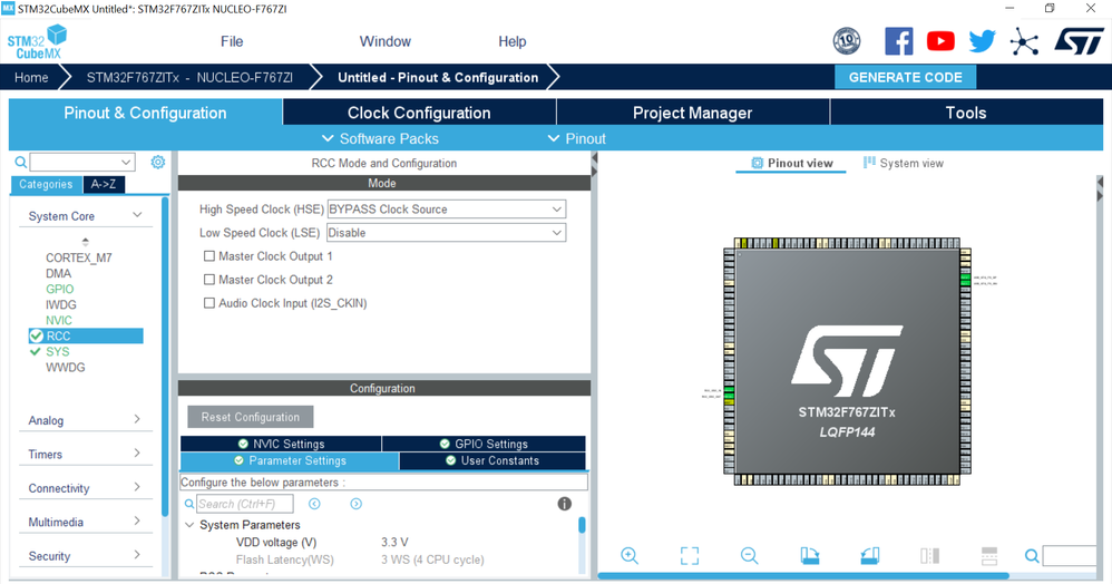

  • First go to System Core ==> select RCC ==> click on High speed Clock and choose "BYPASS clock source "

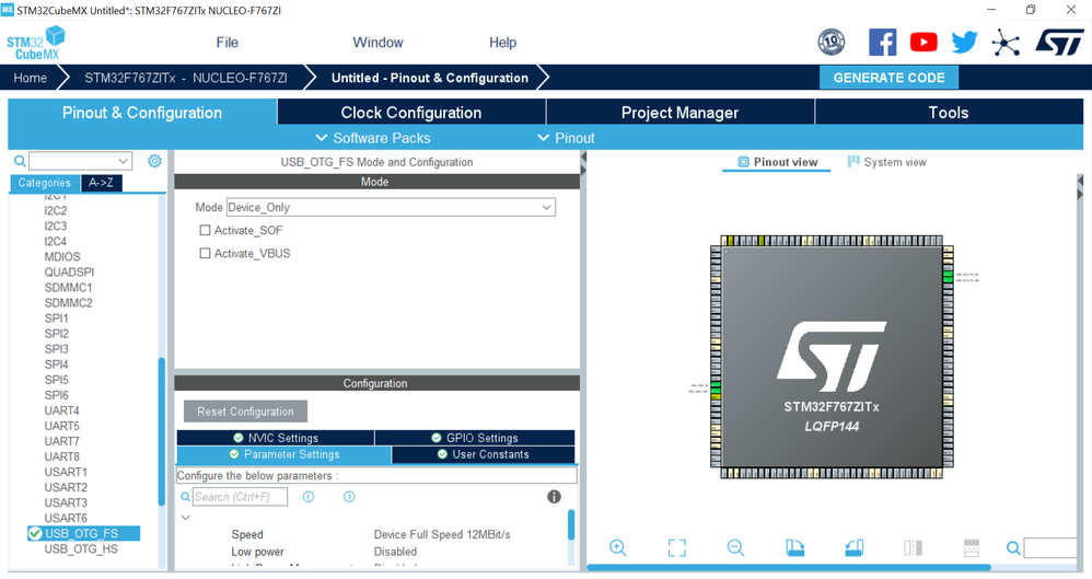

  • Third go to "connectivity" and select USB_OTG_FS click on Mode and select "device only"

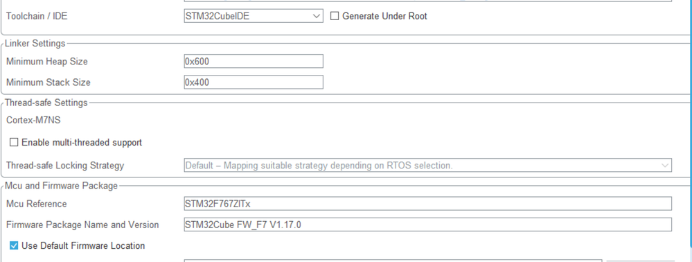

  • finally go to "project manager " and increase the Heap size to 0x600 and generate your code
0693W00000StjrMQAR.png you will find bellow the cubeMX file please have a look
