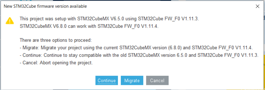

Now feeling like I would have a good chance at victory I opened the same project up and got this:

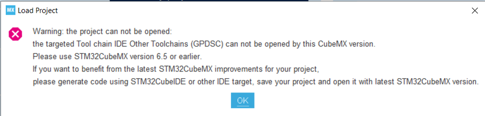

If I click “Continue�? or "Migrate" I get an error message about a GDSC error in the toolchain and it doesn’t load at all.
This means that you've selected generation of a makefile project (not Eclipse/CubeIDE or Keil or IAR). Is this what you use? IIRC this option has been changed in some recent Cube version. In v. 6.8 it is called "makefile".
