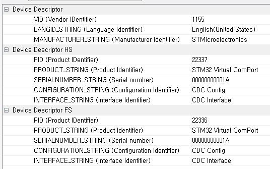

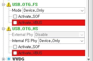

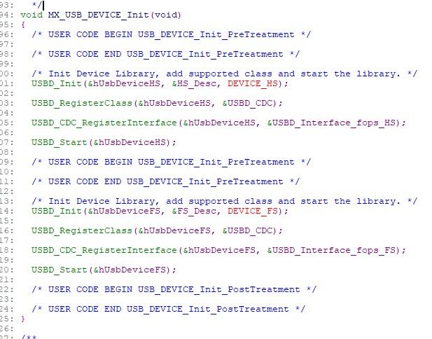

Hello. I'm using EVM board with STM32F407ZGT.
I set up the USB as below to use it as a USB Device. (CDC)
But only one COM port can be found in the device manager on the PC.
I want to know if I can't set 2 usb device or if it's a problem with setting.

Hello @DJung.3
You need to register two instances with USBD_RegisterClassComposite.
  /* Init Device Library */
  USBD_Init(&USBD_Device, &COMPOSITE_Desc, 0);
  /* Register CDC class first instance */
  USBD_RegisterClassComposite(&USBD_Device, USBD_CDC_CLASS, CLASS_TYPE_CDC, CDC_EpAdd_Inst1);
  /* Register CDC class second instance */
  USBD_RegisterClassComposite(&USBD_Device, USBD_CDC_CLASS, CLASS_TYPE_CDC, CDC_EpAdd_Inst2);
  /* Add CDC Interface Class */
  if (USBD_CMPSIT_SetClassID(&USBD_Device, CLASS_TYPE_CDC, 0) != 0xFF)
    USBD_CDC_RegisterInterface(&USBD_Device, &USBD_CDC_fops);
  if (USBD_CMPSIT_SetClassID(&USBD_Device, CLASS_TYPE_CDC, 1) != 0xFF)
  /* Start Device Process */
  USBD_Start(&USBD_Device);
Best regards,
FBL
